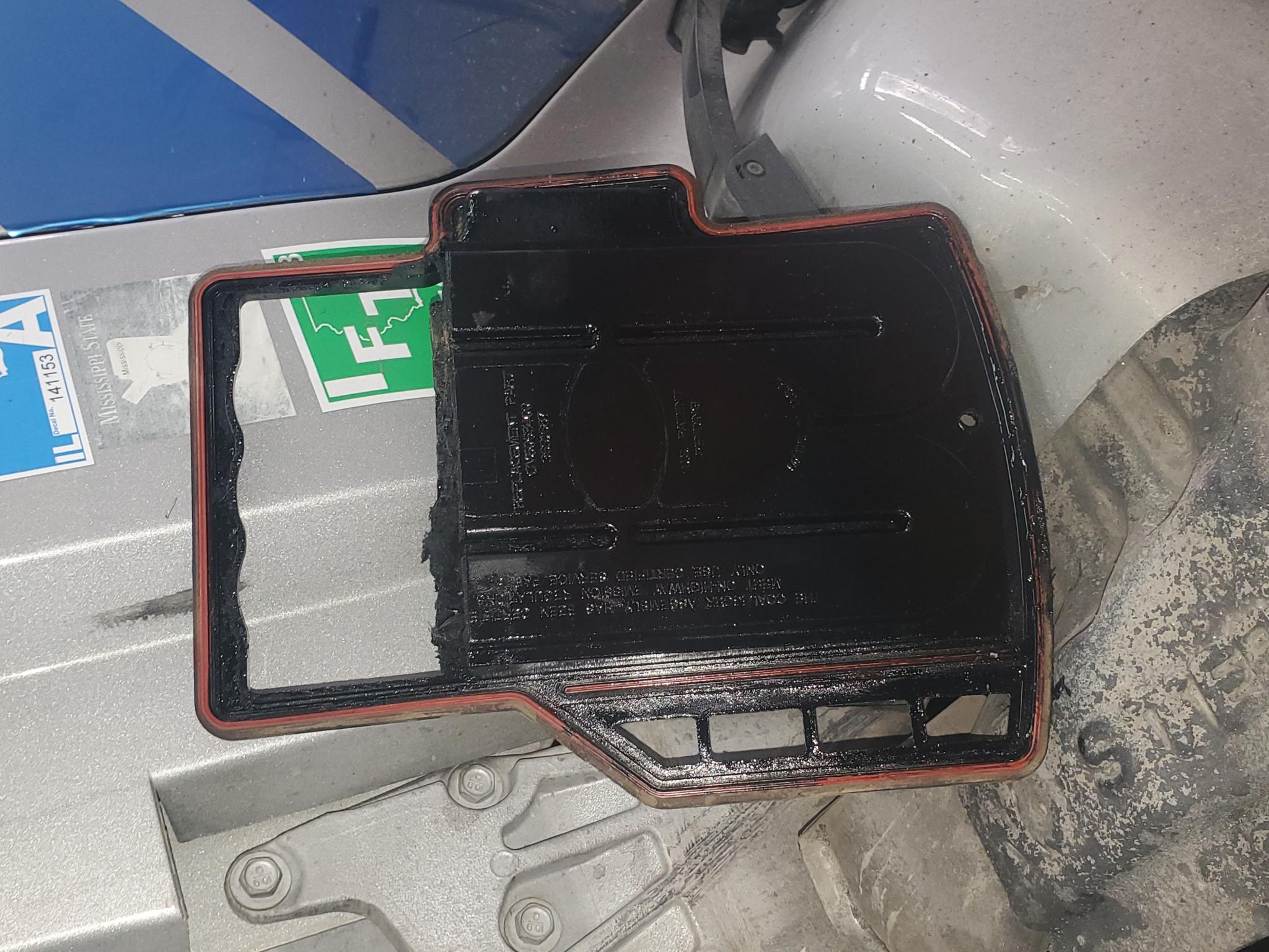

FIRST.. if your truck is de-mandated, then you should have had a maintenence free crank case filter in it, or it should have been drilled out, etc..
Is that filter in the photo what it looked like, cut up like that when it cam out? ... or did you cut it up like that after realizing it was completely clogged?. - A dirty and clogged up crank case filter will cause turbocharger damage, bleeding turbo, etc... AND cause the the overhead cam(s) in the engine to flake out, because the cam(s) will get starved of oil.

the crankcase filter was like that,also there was slight film of oil on boost sensor when i replaced it

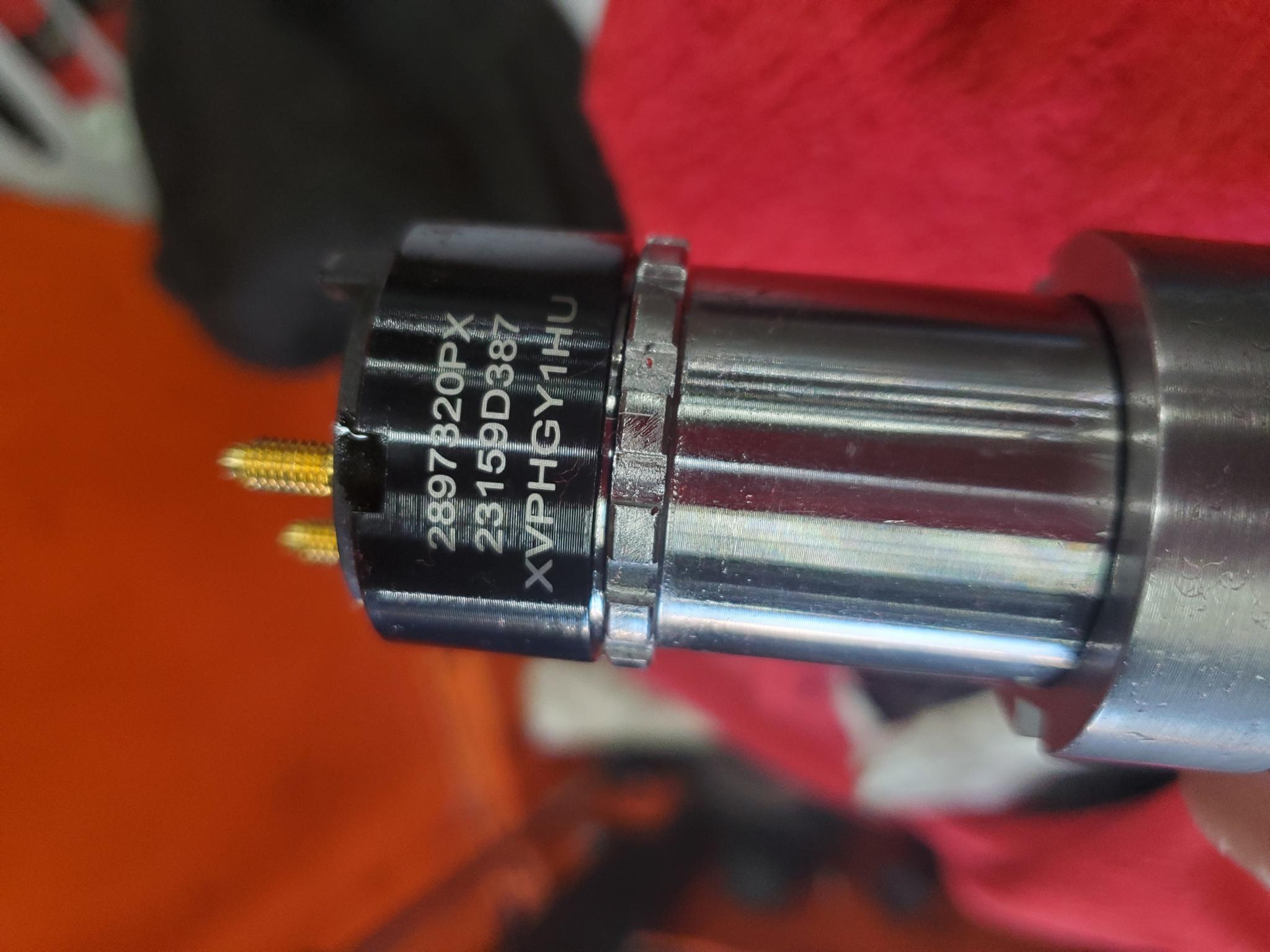

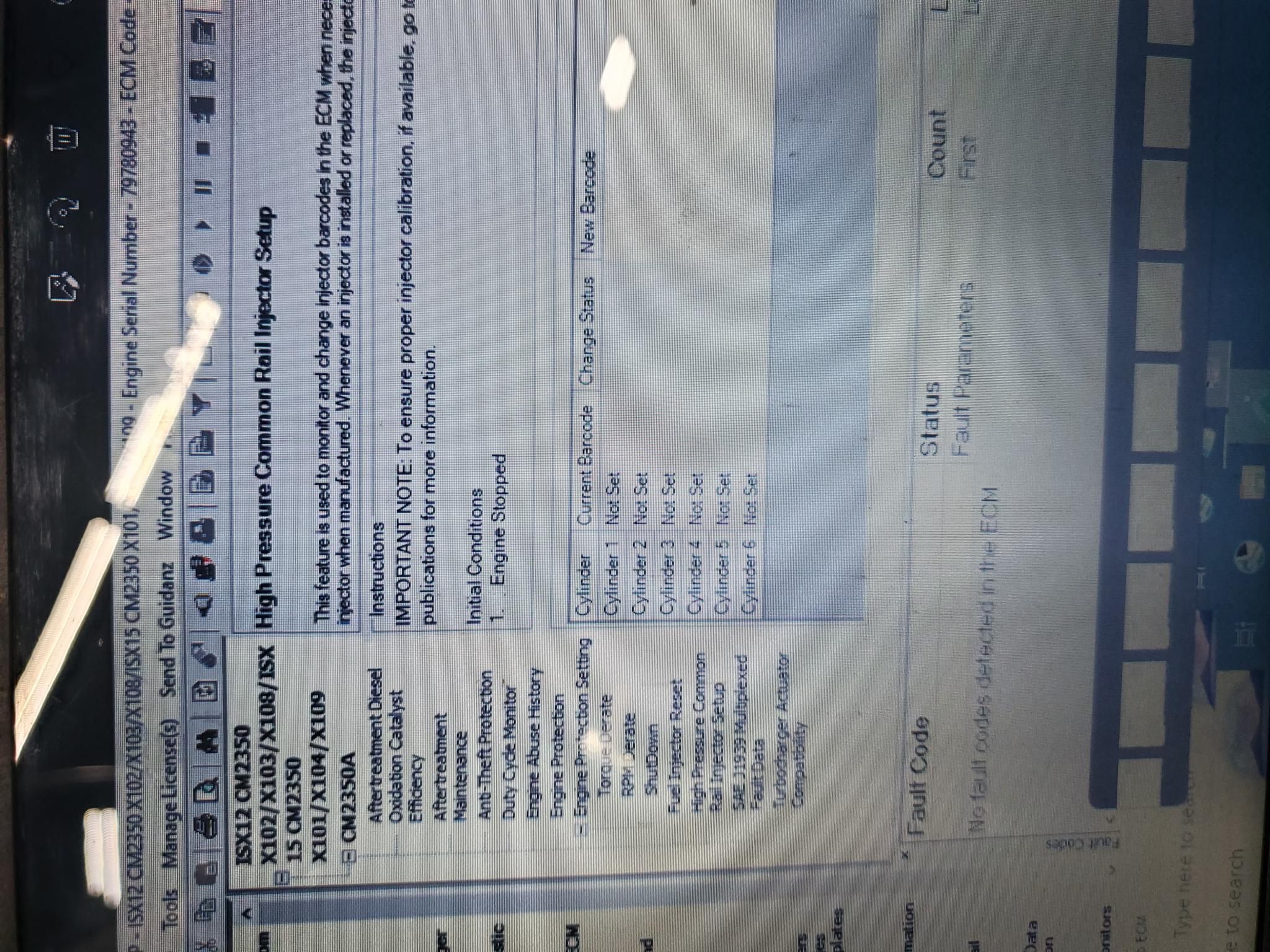

have replaced pressure relieve valve , inspected the high pressure pump (rollers looked like new) ,no trim codes on injectors so might be aftermarket ones
so i run a fuel system test pressure goes up to around 15k when relieve valve opens up and pressure drops a little and goes up to 29k
no trim code on insite also
picture of injector is OEM
when you do a leak test and pressure goes up engine or pump starts to give you a little noise (assume works harder) at about 25k at this truck it starts to make noise at about 17k
any clues what i could test here
as stated before it drops from 29k to 150psi within less than 20sec

2350 injectors wont always show trims in insite as they can be reset. You can put in the trim code and it will take accept them but wont show the trim code, easier to just reset them as needed.
Your injector leakage quantity is in spec so for now ignore the injectors, they are not the issue until the rest of the steps are taken
