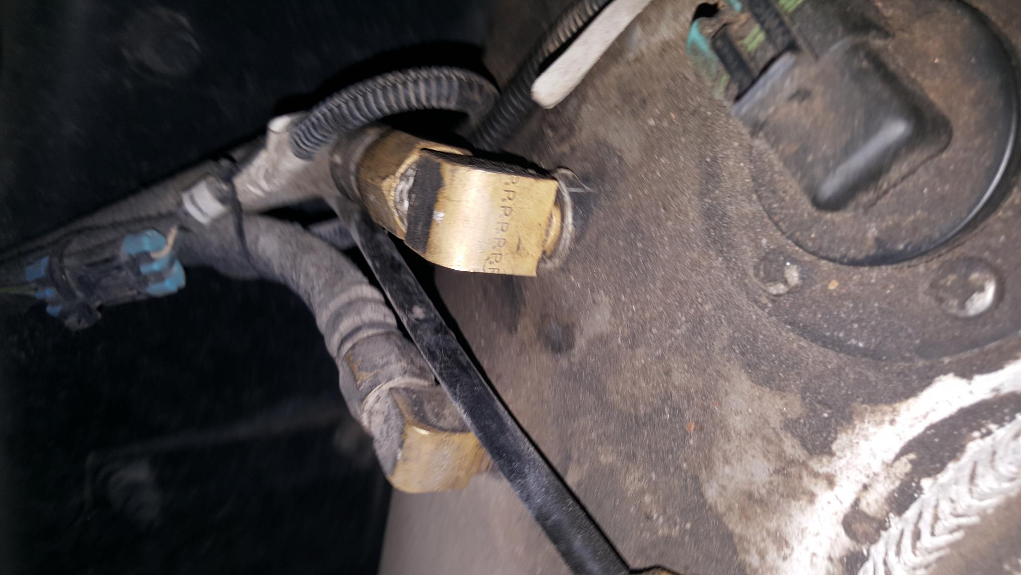

| RE: Paccar fuel filter doesn't stay full I think my reply and question got passed over because this guy posted in my thread. On the fuel line on the passenger side tank there's dirty looking fuel. I had a mechanic tell me that wouldn't cause a problem. I tried tightening the fitting. Do you think that's causing the problem? Should I replace that hose? Thanks. | |||

RE: Paccar fuel filter doesn't stay full (02-28-2018 )aaronb Wrote: I think my reply and question got passed over because this guy posted in my thread. On the fuel line on the passenger side tank there's dirty looking fuel. I had a mechanic tell me that wouldn't cause a problem. I tried tightening the fitting. Do you think that's causing the problem? Should I replace that hose? Thanks. Any fuel leak in a fuel line is a problem that should be fixed right away. Maybe post some pictures? User's Signature: ->: What I post is just my own thoughts and Opinions! --- I AM Full Of S__T!. | |||

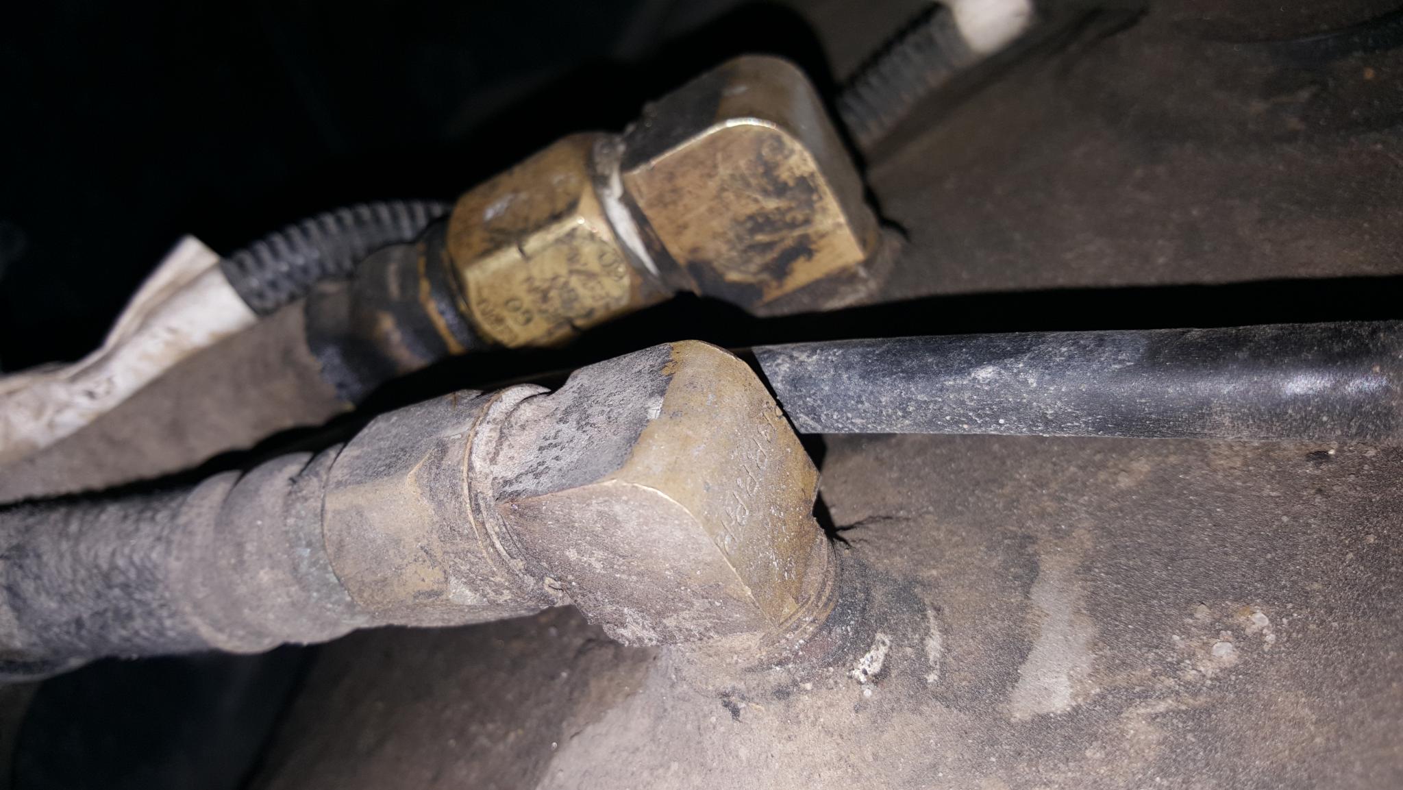

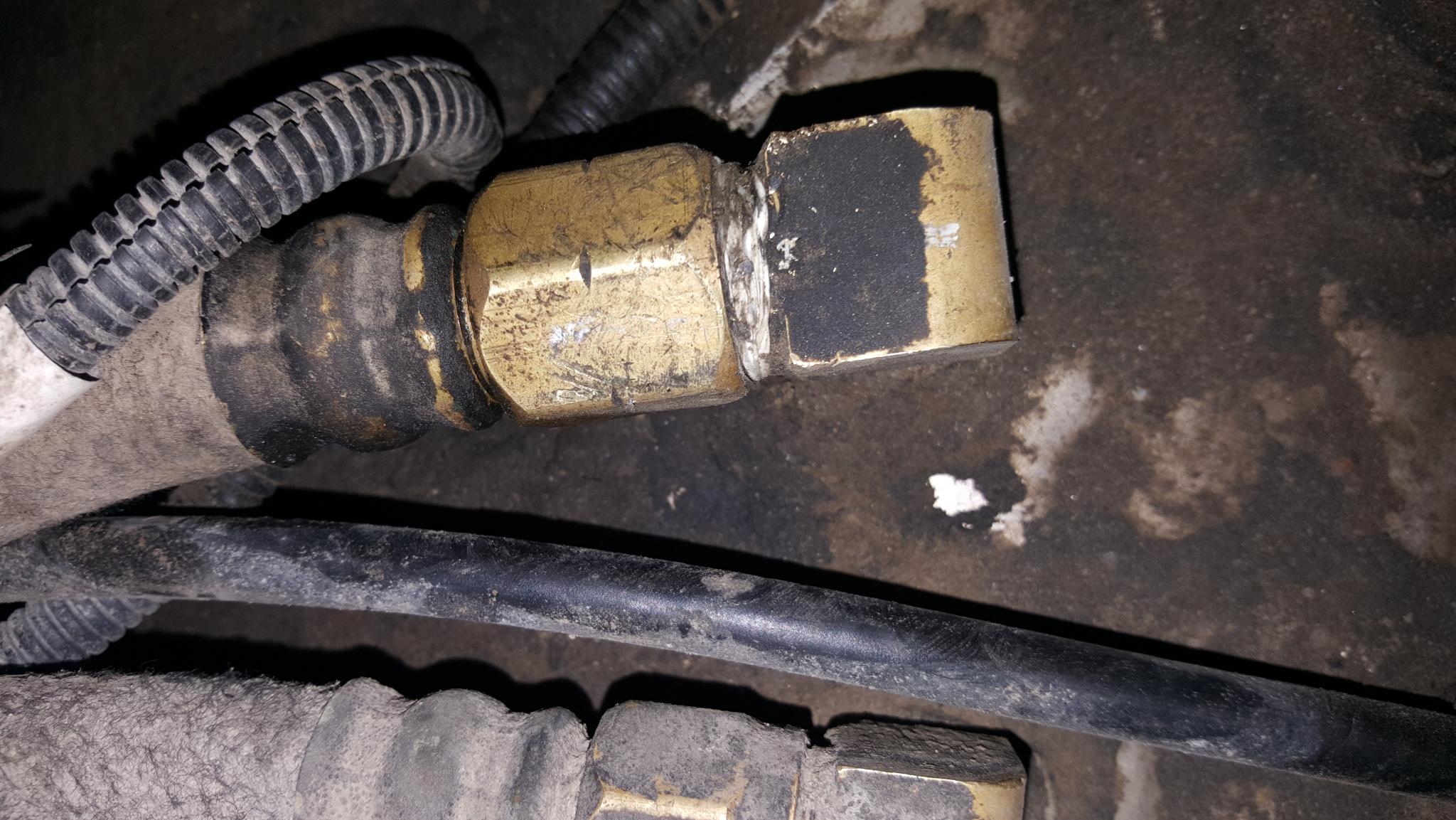

| RE: Paccar fuel filter doesn't stay full Here's a few pictures. I just sprayed it with carburetor cleaner to try and clean it up some so I can try and see where the leak is. | |||
