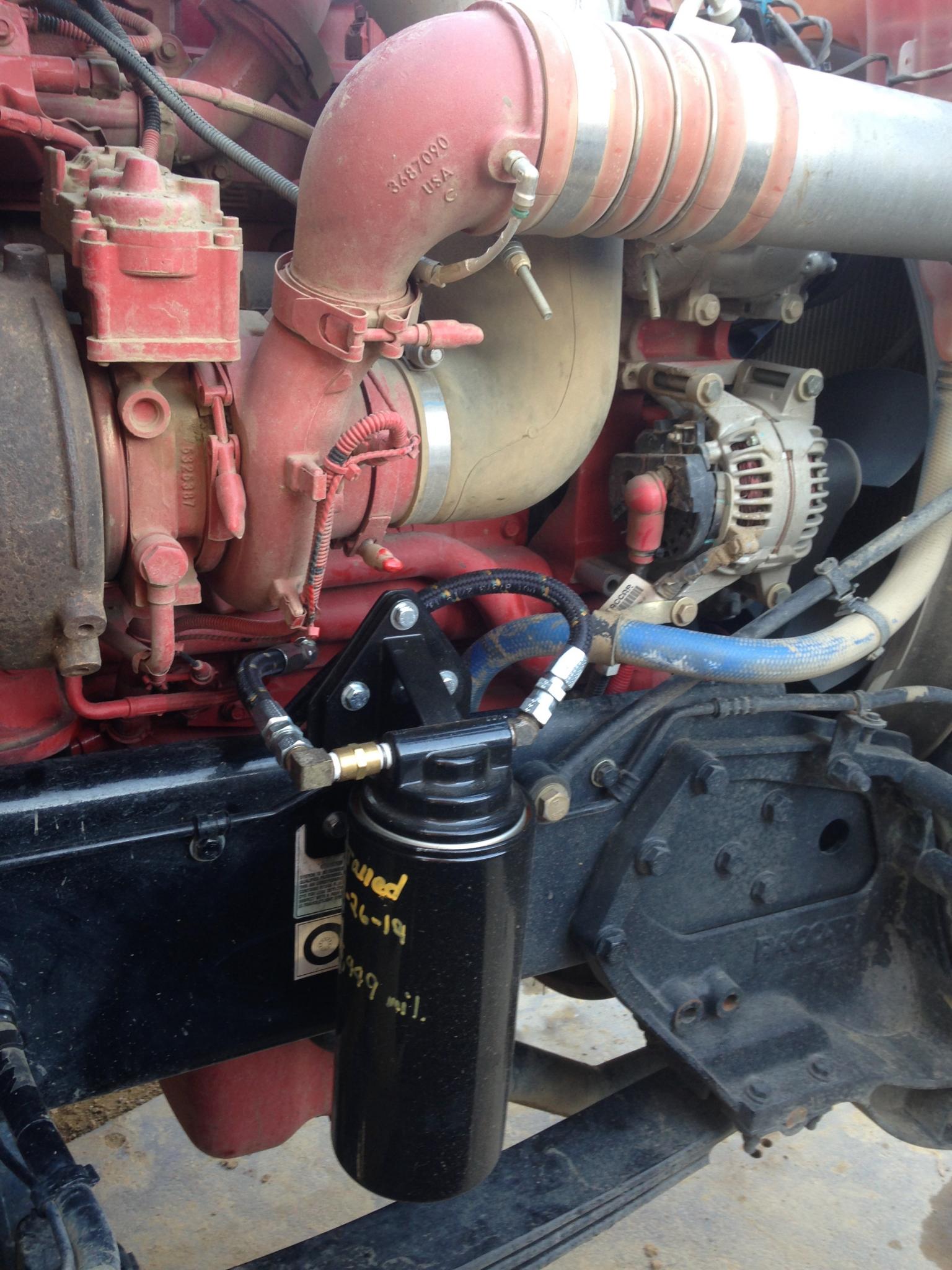

   I just installed one on 2018 KW
 Thanks given by: Waterloo , LargeCar
01-03-2020, (Subject: ISX and Bypass Oil Filter Systems )
Post: #99
RE: ISX and Bypass Oil Filter Systems
(01-03-2020 )arch_stanton Wrote:  I just installed one on 2018 KW
you mounted it a bit differently from what i have seen most people make their own J bolts. A close up of what you did there would be nice. how hard was it to get mounted? it looks nice and clean good job by the way!
