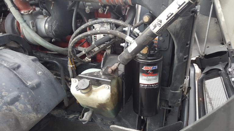

./uploads/201607/post_2126_1468369344_c04697e9d5bfd10eb980dcc08ac3cb64.jpg
Installed! 2009 Kenworth T2000, ISX CM871
 Thanks given by: LargeCar
07-12-2016, (Subject: ISX and Bypass Oil Filter Systems )
Post: #43
RE: ISX and Bypass Oil Filter Systems
(07-12-2016 )jelshant Wrote:  Installed! 2009 Kenworth T2000, ISX CM871
That looks nice! Good job! What did you use for a bracket to mount the filter?

(07-12-2016 )jelshant Wrote:  Installed! 2009 Kenworth T2000, ISX CM871/ i used a stainless steel 1/4 inche that was laying around at my father's. We ended up welding a piece of angled iron to connect the s/steel plate to the original metal bracket that holds the washer fluid tank. I'll get another pic and post it soon.
