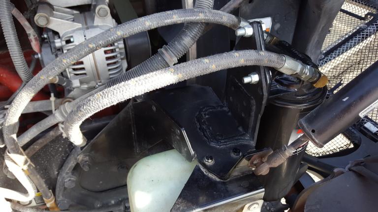

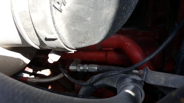

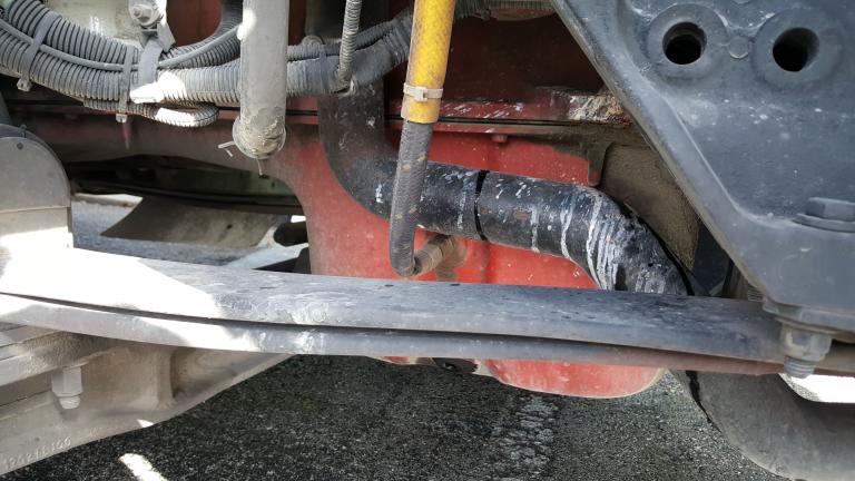

./uploads/201607/post_2126_1468417253_b695f29588fd460a928f7a1dfb91f53a.jpg./uploads/201607/post_2126_1468417223_e742d3f5e9937570799974cc4efb4a4f.jpg./uploads/201607/post_2126_1468417182_c7ae0d8d9b91119c7a280c483dcc6765.jpg
(07-13-2016 )jelshant Wrote:
(07-12-2016 )jelshant Wrote:  Installed! 2009 Kenworth T2000, ISX CM871/ i used a stainless steel 1/4 inche that was laying around at my father's. We ended up welding a piece of angled iron to connect the s/steel plate to the original metal bracket that holds the washer fluid tank. I'll get another pic and post it soon.
 Thanks given by: fargonaz , Roysbigtoys , freddy , LargeCar

I was curious if anyone was using the hole in the side of the pan for the return line. Now I know.
