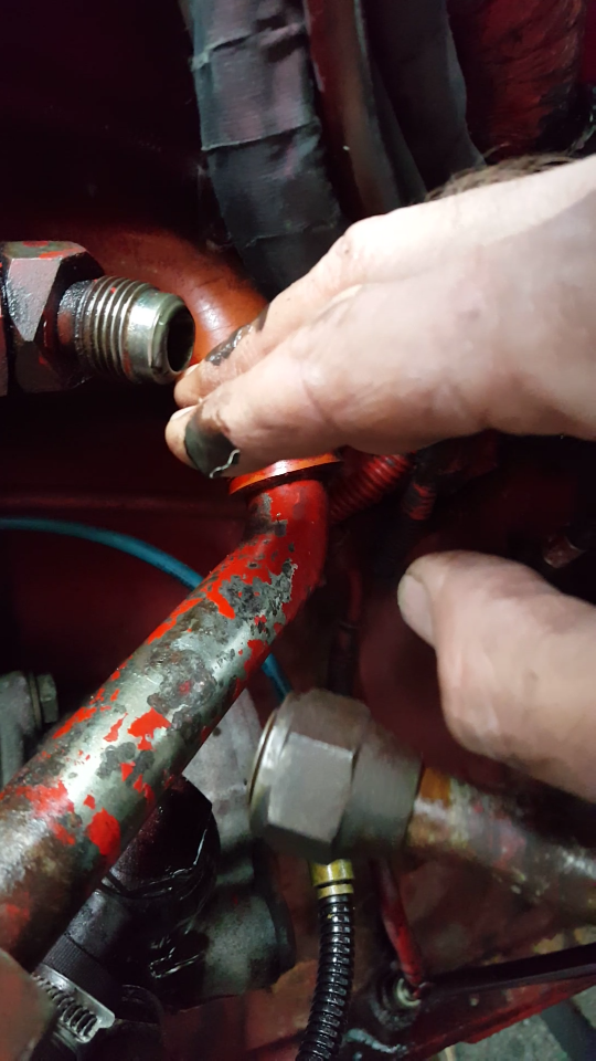

(11-13-2018 )Lonestar10 Wrote:  i do beleive an air compressor can also throw pressure into CC
I checked yesterday I do have oil coming out of the compressor discharge port.

11-15-2018, (Subject: Crankcase pressure/volume build up )
RE: Crankcase pressure/volume build up
that could cause a lot of issues with the air systems later on.
