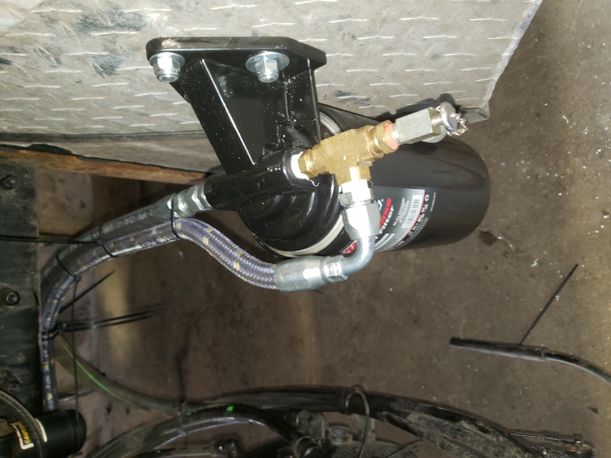

| Installing a amsoil bypass filter I am installing a amsoil bypass filter and need a little assistance. Ware should I put the pressure and return lines on my ISX ?[/align] | |||

| RE: Installing a amsoil bypass filter update Ok update I think I got it I installed the filter behind the sleeper...no other place...I found a picture of the oil cooler with numbers on the ports I used #5 and my return is in a plug on the block on the oil pan flange to the rear of the filter | |||

| RE: Installing a amsoil bypass filter Here is a picture of the cooler I used #5 I hope this is ok | |||

| RE: Installing a amsoil bypass filter looks like the right one. some of the other ones can get the hoses burned from being close to turbo or something. User's Signature: Also known as Shotgun | |||
