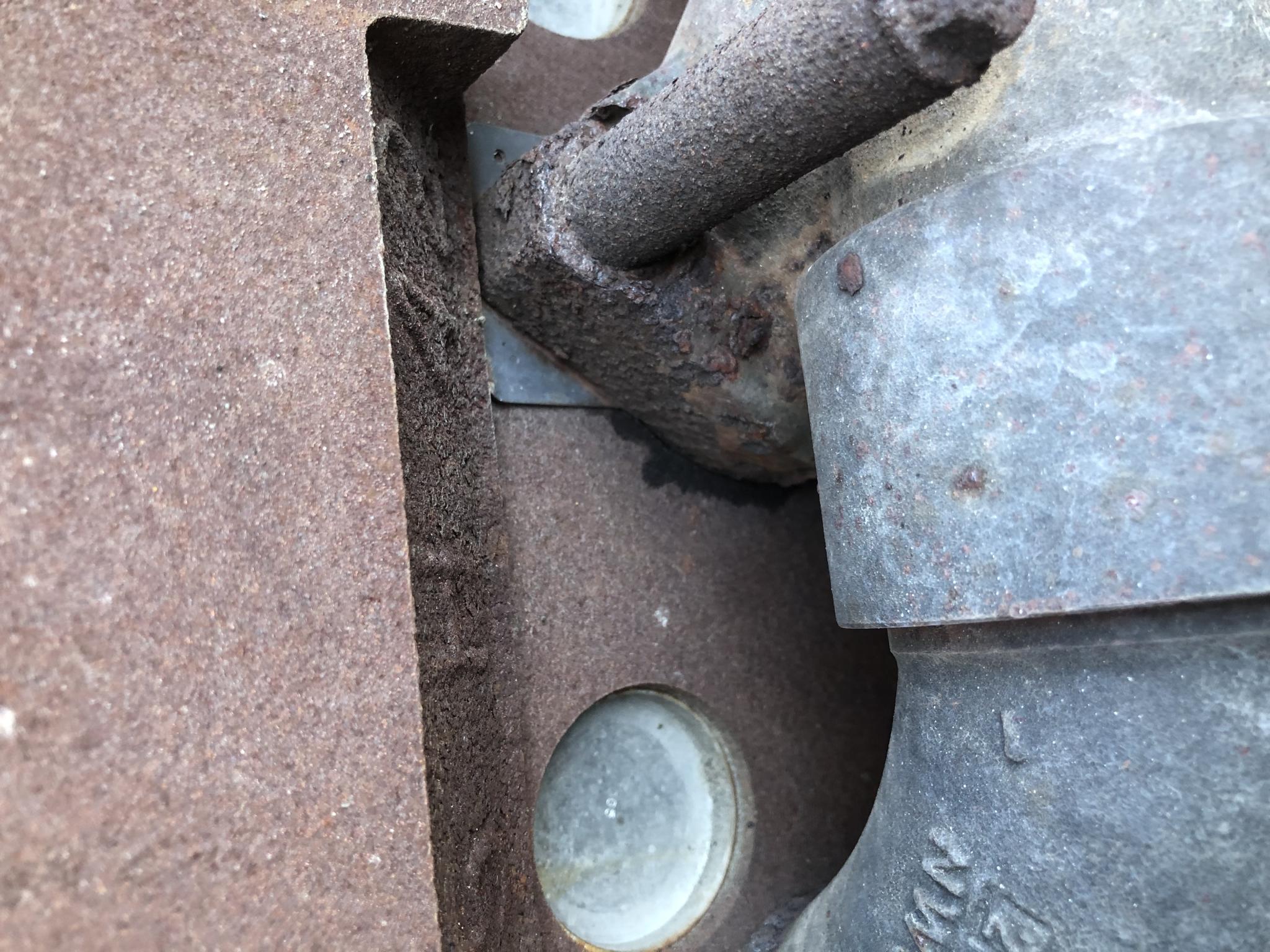

01-30-2020, (Subject: Oil around exhaust manifold. ) Post: #1 | |||
Oil around exhaust manifold. | |||
01-30-2020, (Subject: Oil around exhaust manifold. ) Post: #2 | |||
RE: Oil around exhaust manifold. Valve seals most likely. Nothing you can do except replace the head, and with that mileage it would basically mean in frame time. How much oil is it using? User's Signature: im_seeing_parameters_in_my_sleep 1 | |||
01-30-2020, (Subject: Oil around exhaust manifold. ) Post: #3 | |||
RE: Oil around exhaust manifold. | |||
01-30-2020, (Subject: Oil around exhaust manifold. ) Post: #4 | |||
RE: Oil around exhaust manifold. (01-30-2020 )Mrkentee Wrote:(01-30-2020 )tree98 Wrote: Valve seals most likely. Nothing you can do except replace the head, and with that mileage it would basically mean in frame time. How much oil is it using? Yes, they can. User's Signature: It's hard to win an argument with a smart person, but it's damn near impossible to win an argument with a stupid person | |||
01-31-2020, (Subject: Oil around exhaust manifold. ) Post: #5 | |||
RE: Oil around exhaust manifold. i would not worry about it unless you start seeing a lot of smoke out the exhaust or oil consumption goes up. User's Signature: ->: What I post is just my own thoughts and Opinions! --- I AM Full Of S__T!. | |||
01-31-2020, (Subject: Oil around exhaust manifold. ) Post: #6 | |||
RE: Oil around exhaust manifold. Mine had that same oil coming out of cylinder 6. It had a broken manifold bolt. Tore it apart to fix the broken bolt. Everything checked out fine. If anything, hose it down with brake clean and check it for exhaust leaking. Hammerhead had a fun little trick of smoking a cigar, while its running, around the port to see if its leaking. Maybe fire up the truck and a stogie to see if there is a leak. | |||
01-31-2020, (Subject: Oil around exhaust manifold. ) Post: #7 | |||
RE: Oil around exhaust manifold. (01-30-2020 )Mrkentee Wrote:(01-30-2020 )tree98 Wrote: Valve seals most likely. Nothing you can do except replace the head, and with that mileage it would basically mean in frame time. How much oil is it using? The question would be, is it worth it? My opinion it wouldn't be. User's Signature: im_seeing_parameters_in_my_sleep 1 | |||
01-31-2020, (Subject: Oil around exhaust manifold. ) Post: #8 | |||
RE: Oil around exhaust manifold. Also if doing alot of idling the cylinder can wet stack this may be the issue. Check crankcase filter if haven't already change it out to maintenance free one. And like said before may be a exhaust leak there.. | |||
01-31-2020, (Subject: Oil around exhaust manifold. ) Post: #9 | |||
RE: Oil around exhaust manifold. (01-31-2020 )tree98 Wrote:Its not a huge job, from what I can tell.(01-30-2020 )Mrkentee Wrote:(01-30-2020 )tree98 Wrote: Valve seals most likely. Nothing you can do except replace the head, and with that mileage it would basically mean in frame time. How much oil is it using? http://rawze.com/forums/showthread.php?tid=1034&page=2 | |||
