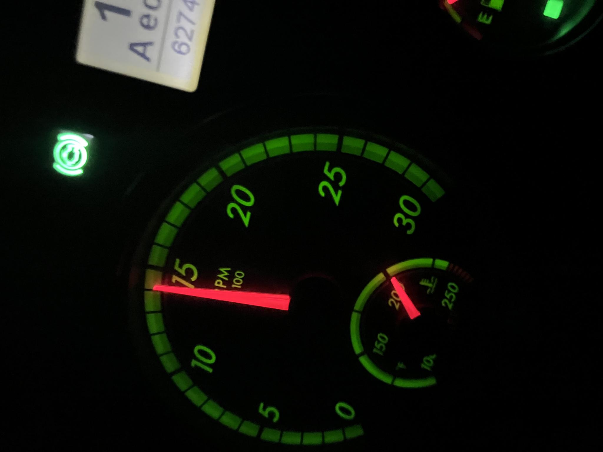

Having issue with Digital Temp Reading something and Analog Temp Gauge reading another thing…
First question, Digital says 220f Analog is mostly at 200f and will sometimes go up depending on hills or weather.
Does anyone know where digital is getting 220 and analog is getting 200? Aren’t both sensors reading the same thing? Can someone explain
Also second question, truck seems to be overheating after replacing the radiator, what can cause this? I notice it’s overheating when I’m doing 70 but when I’m doing 60-65 it’s right about normal temps I’ve seen the past 3 years.

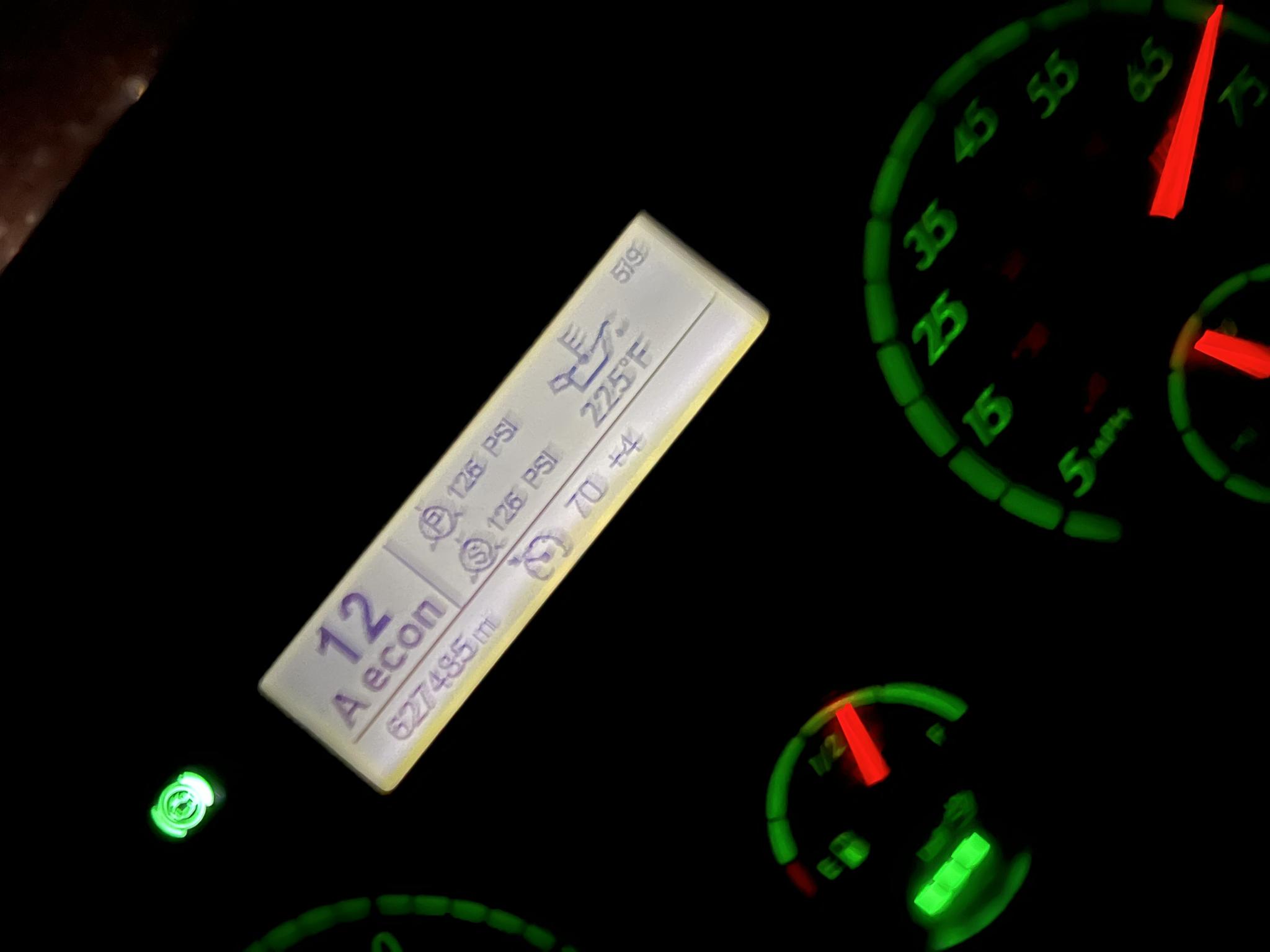

I have attached both temp readings as you can see analog is at 200 which I would assume it’s not overheating but digital shows 225 which I would definitely say it’s overheating

I just noticed 200 is coolant temperature which is not overheating and 225f is temp for engine oil…. Smh
06-30-2023, (Subject: Coolant Temp Sensor ISSUES )
RE: Coolant Temp Sensor ISSUES
Is 225 -230f alright for engine oil temp?
(06-30-2023 )lesvraissavent Wrote:  Is 225 -230f alright for engine oil temp?
Yessir everything looks normal. Just gonna make a suggestion though that could save you $20,000. With your truck having 600k miles on it I strongly suggest to change the oil suction module. There is a square insert in it that will break out and when it does it causes your bearings to spin before you can pull off the road….. just a suggestion
