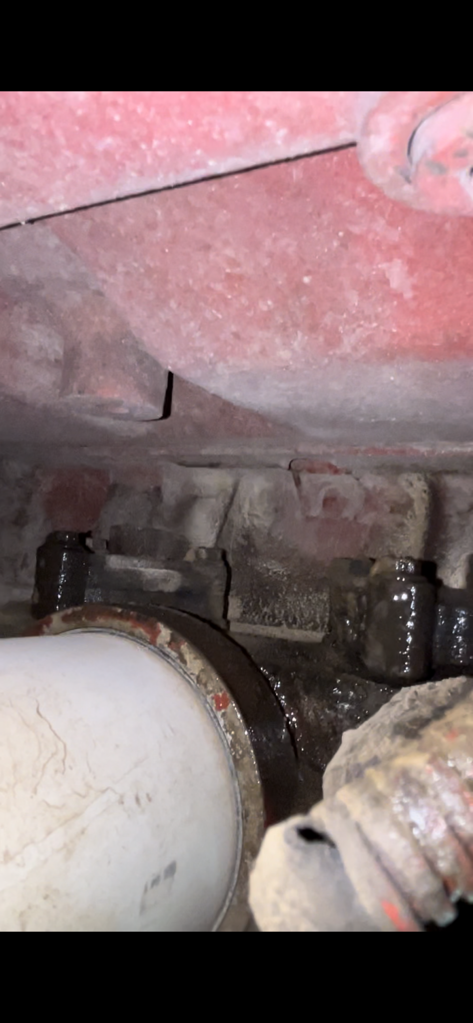

| Leak from behind CM870 fuel pump Hello.I have a leak on the back end of my fuel pump just behind the fuel filter.There is two triangle shaped ports and it has a constant leak from one of them.Just discovered this morning in my pre-trip when I noticed two drips of fuel on the block and a weird idle at startup | |||

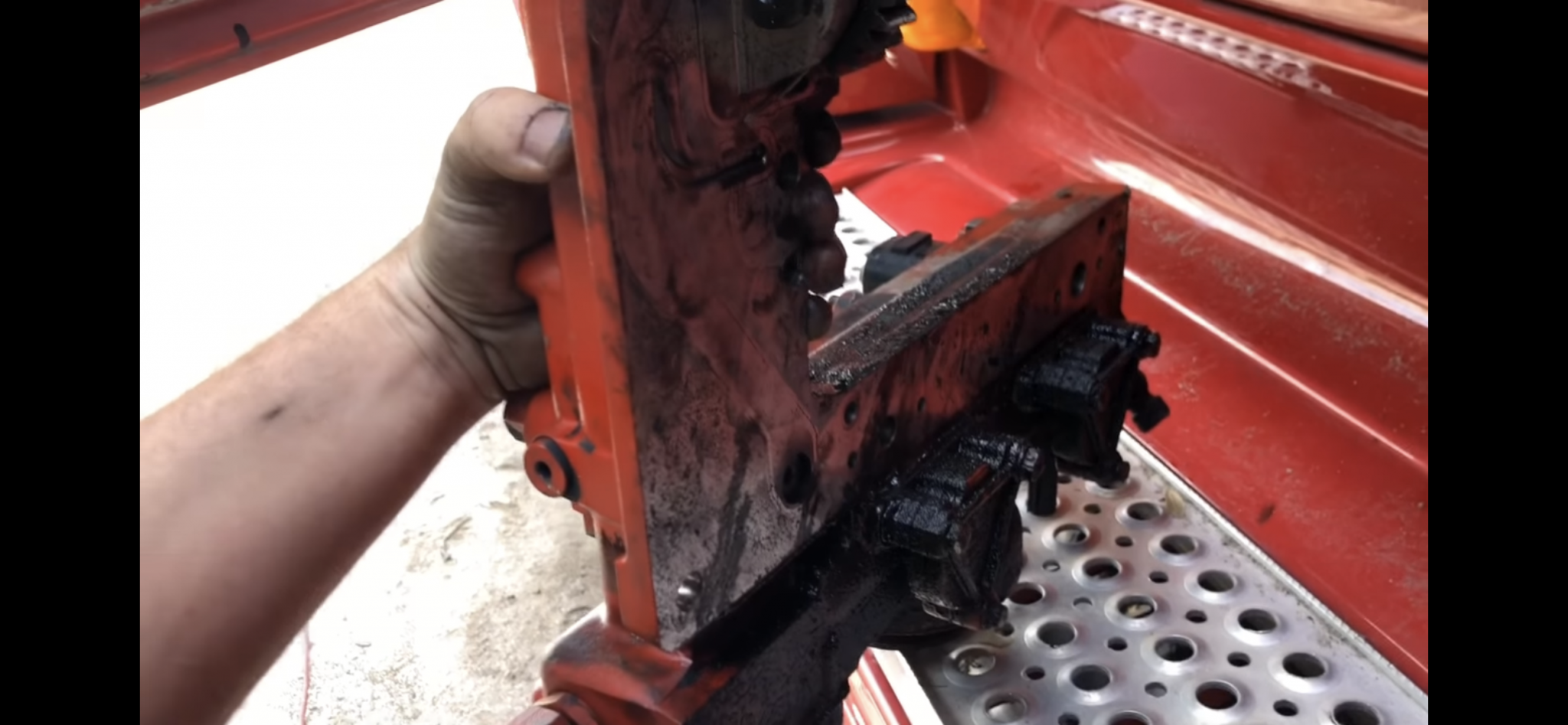

| RE: Leak from behind CM870 fuel pump So I found a picture of the two triangle pieces that are leaking.What are those and is the leak common? | |||
| 08-31-2023, (Subject: Leak from behind CM870 fuel pump ) Post: #3 | |||
| RE: Leak from behind CM870 fuel pump Yeah it’s pretty common, cheap fix just a few gasket, but the whole ISFM does need to be removed. Take your time, clean everything nicely before putting it back together, torque the bolts and use anti seize User's Signature: I may be cross eyed, but i don’t cross thread | |||
| 08-31-2023, (Subject: Leak from behind CM870 fuel pump ) Post: #4 | |||
| RE: Leak from behind CM870 fuel pump Those triangle pieces are dampers for the fuel solenoids to help them with a more consistent plunger operation. User's Signature: ->: What I post is just my own thoughts and Opinions! --- I AM Full Of S__T!. | |||

RE: Leak from behind CM870 fuel pump (08-31-2023 )Andre_The_Giant Wrote: Yeah it’s pretty common, cheap fix just a few gasket, but the whole ISFM does need to be removed. Take your time, clean everything nicely before putting it back together, torque the bolts and use anti seize Hopefully I didn’t mess them up I tried tightening them to see if the leak stopped . | |||

| RE: Leak from behind CM870 fuel pump Once the damper’s are reassembled is there supposed to be a little gap between both covers? | |||
| 09-01-2023, (Subject: Leak from behind CM870 fuel pump ) Post: #7 | |||
| RE: Leak from behind CM870 fuel pump Can u take a pic? I’m sure it’s fine it would be pretty hard to f them up User's Signature: I may be cross eyed, but i don’t cross thread | |||
| 09-01-2023, (Subject: Leak from behind CM870 fuel pump ) Post: #8 | |||
RE: Leak from behind CM870 fuel pump (09-01-2023 )Andre_The_Giant Wrote: Can u take a pic? I’m sure it’s fine it would be pretty hard to f them up I looked and they weren’t cracked.Got the O-ring’s and diaphragm replaced.Tested the truck for about 15-30 minutes today and it didn’t leak.Goong to take it down the road tomorrow and see what it does. | |||
