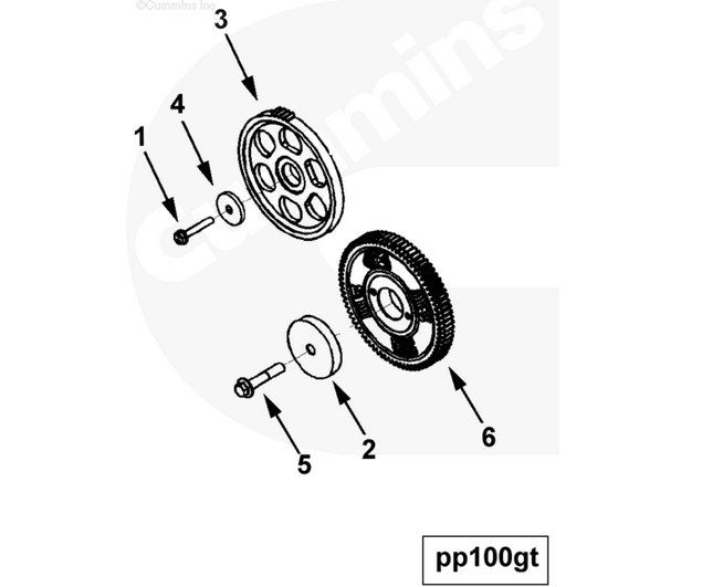

RE: Whinning sound front cover (04-02-2017 )Rockycoon75 Wrote: How long are the pumps good for? Mine was replaced 14 months ago during a overhaul If they re-used the compression spacer on the injector cam then it may have cracked. You are not supposed to re-use the concave type spacer so I would check that too. There are actually 2 types... ![]() Item #2 in the picture is the spacer. If it is the thick flat kind, it is re-usable, but if it the older concave type, it cannot be re-used. This type is NOT re-usable and are known for cracking!. ![]() And this one CAN be re-used ... User's Signature: ->: What I post is just my own thoughts and Opinions! --- I AM Full Of S__T!. | |||
