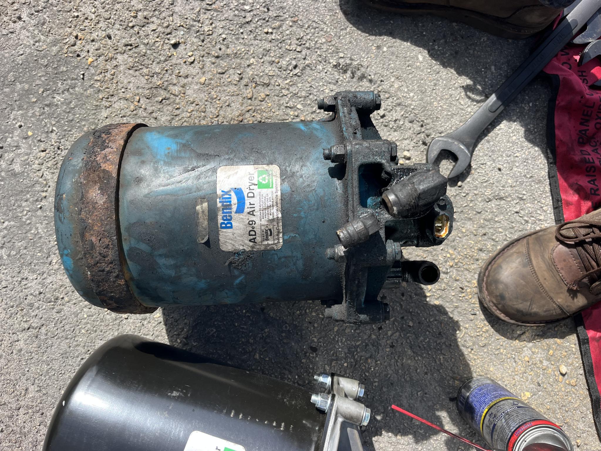

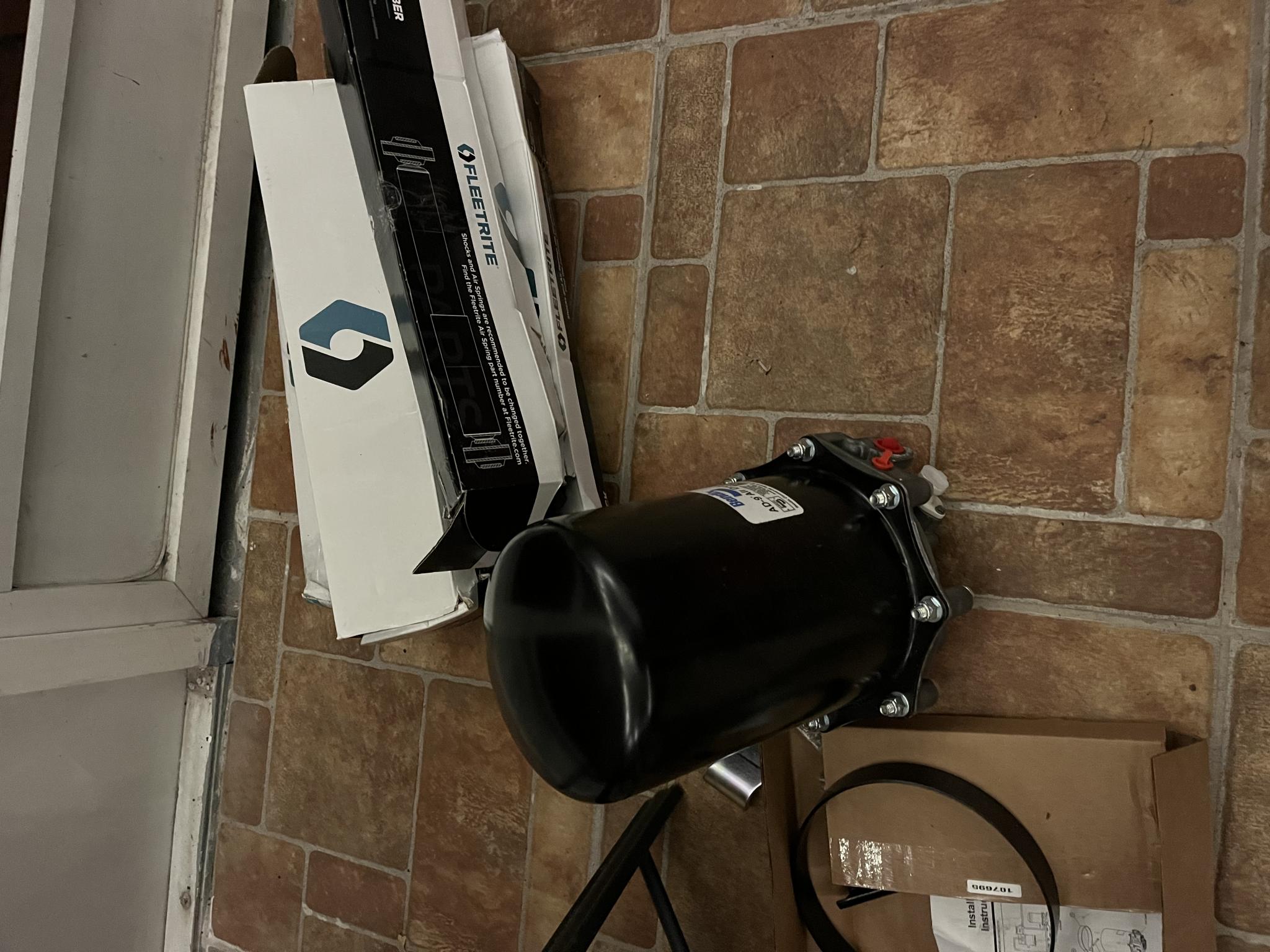

| RE: Purge valve keep going off Dryer replaced 6 months ago, but it did the same thing. Oem bendix. Maybe that was bad somehow ? Idk.I bought another yesterday since there was a deal. Got it for 182 at the dealer, it’s normally 400 for a ab-9 so I took it. | |||

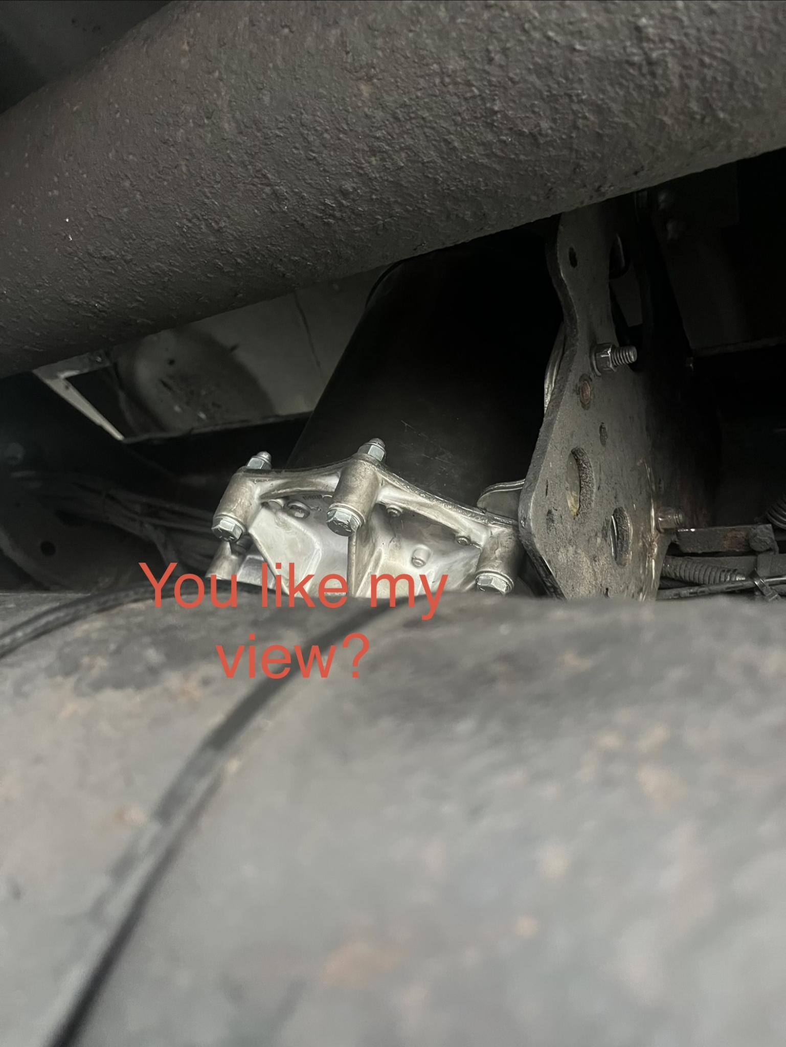

RE: Purge valve keep going off (07-07-2026 )JimT Wrote: I don't know about that model or where you operate, but I usually replace my air dryer cartridge every 6 months or so. My dryer is located under the cab above the two air the tanks and on the left side of the drive shaft geniusly done by international. It’s not the braided hoses your talking about, I know of them though. The hose is the regular dot plastic stuff. I’m still asking, will an air leak cause water in air tank? I’m thinking of relocating my air dryer and Putting it somewhere more accessible because where it is, is a pain in a**. I didn’t get to change it yet because it’s been raining all week. Also to answer your question on leaks if I leave my truck over night and start it back in the morning I only loose like 10-15. Also what do you guy’s think of relocating my dryer. I want to put it on the outside of the frame on the drivers side behind steer Tire like all the other trucks. I’m know mechanic either so correct me if I’m talking bs. I added images down below from the last time I changed it. | |||
