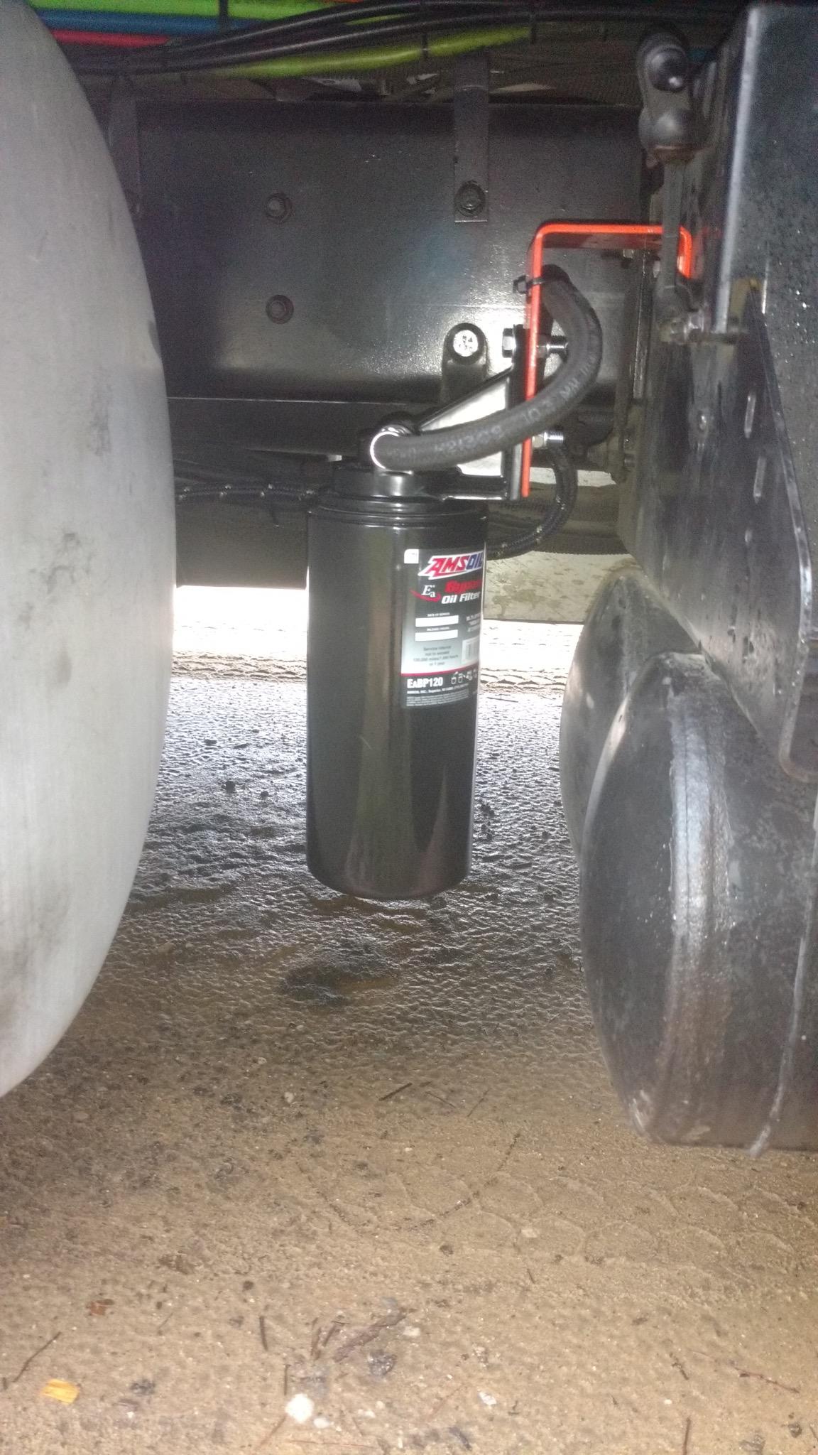

(01-03-2020 )dumptruckisx Wrote:
(01-03-2020 )arch_stanton Wrote:  I just installed one on 2018 KW

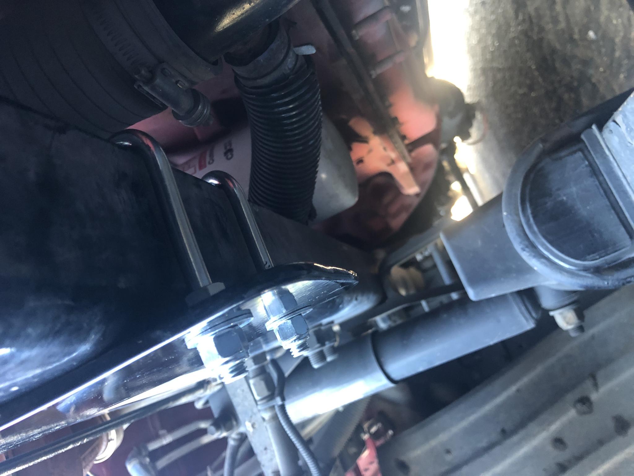

you mounted it a bit differently from what i have seen most people make their own J bolts. A close up of what you did there would be nice. how hard was it to get mounted? it looks nice and clean good job by the way!

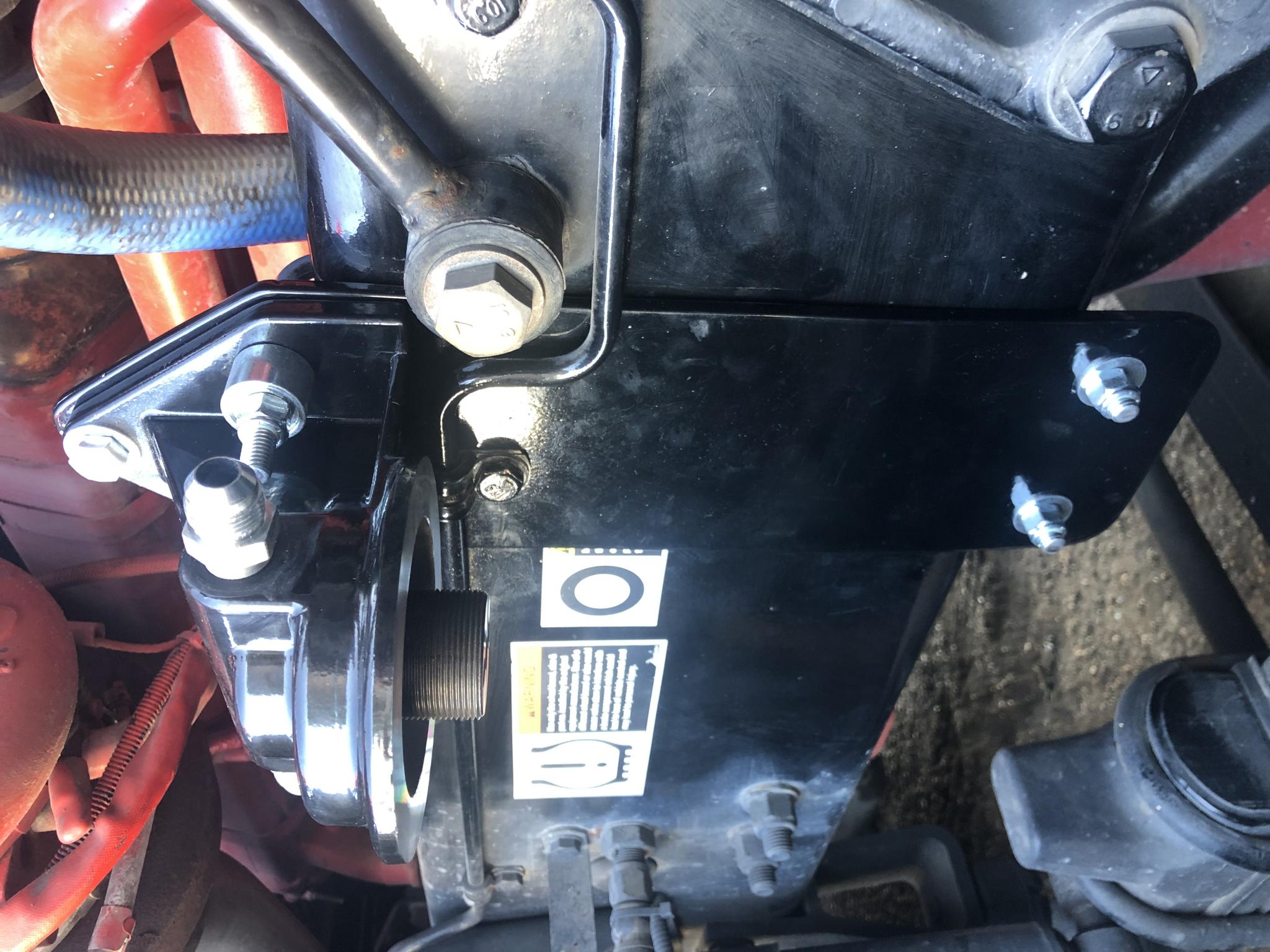

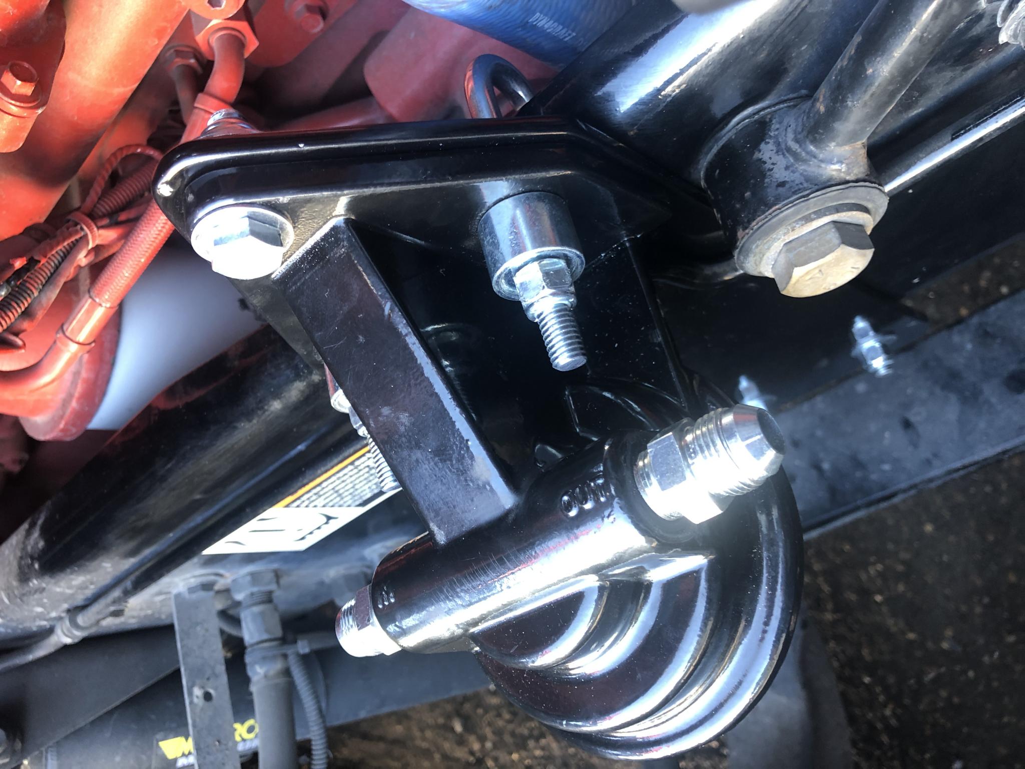

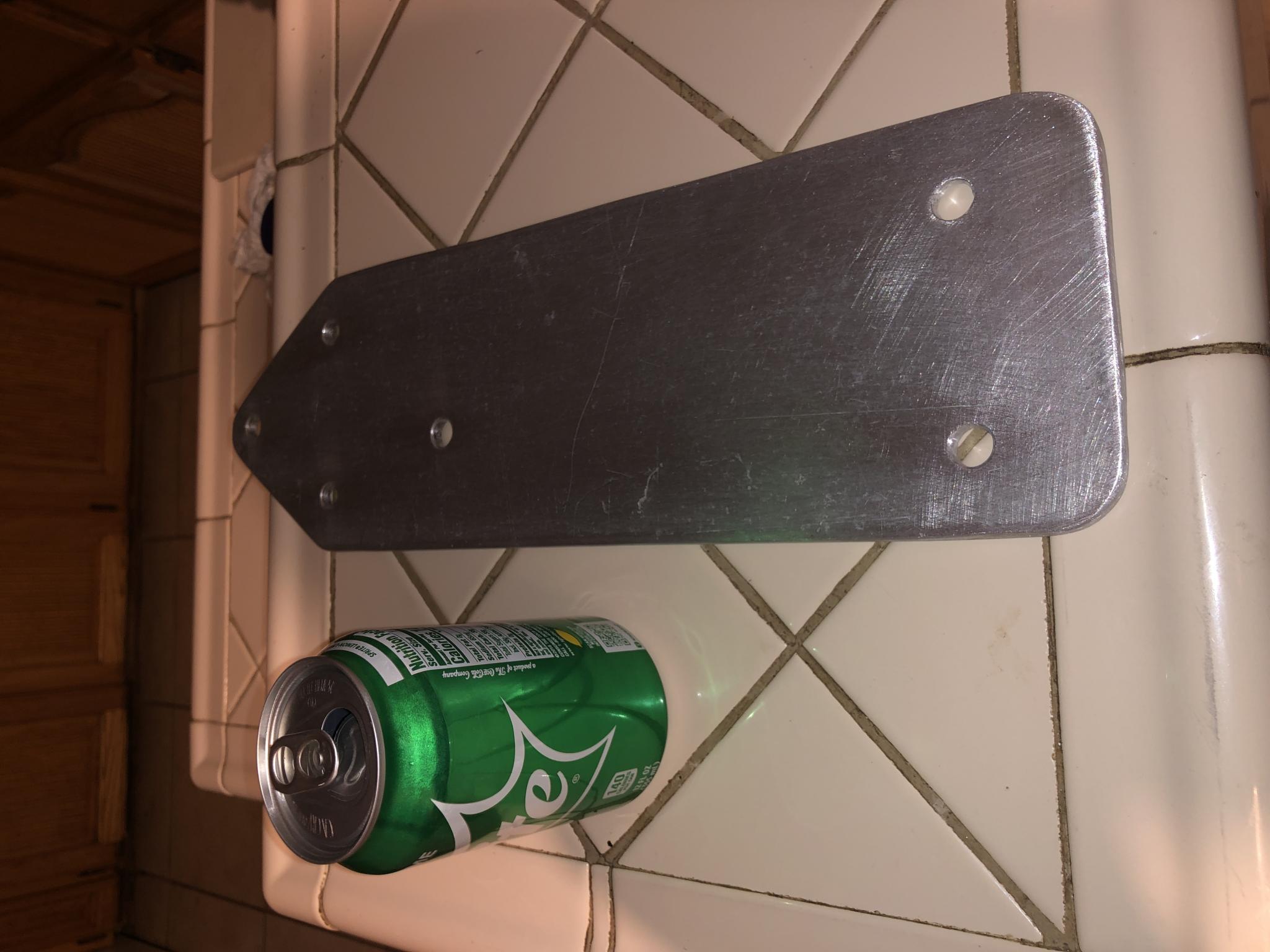

I used a piece of 3/16 t-1 steel and made a plate that is a little bigger than the width of the mount and made it long enough to get 3 inches below top of frame and I spaced the hard ac line out from the frame with one or 2 washers installed between the ac hard line mounting bolt and the frame then installed the plate under the hard line, I am not totally happy with the mount as it shakes a little not as bad as the factory power steering tank but when I do the next one I think I will make the mount a little wider then weld on a flange on the out sides of the plate, I will get more pics and post them latter. the other thing that was took time was nobody had the metric fittings in stock that I wanted.

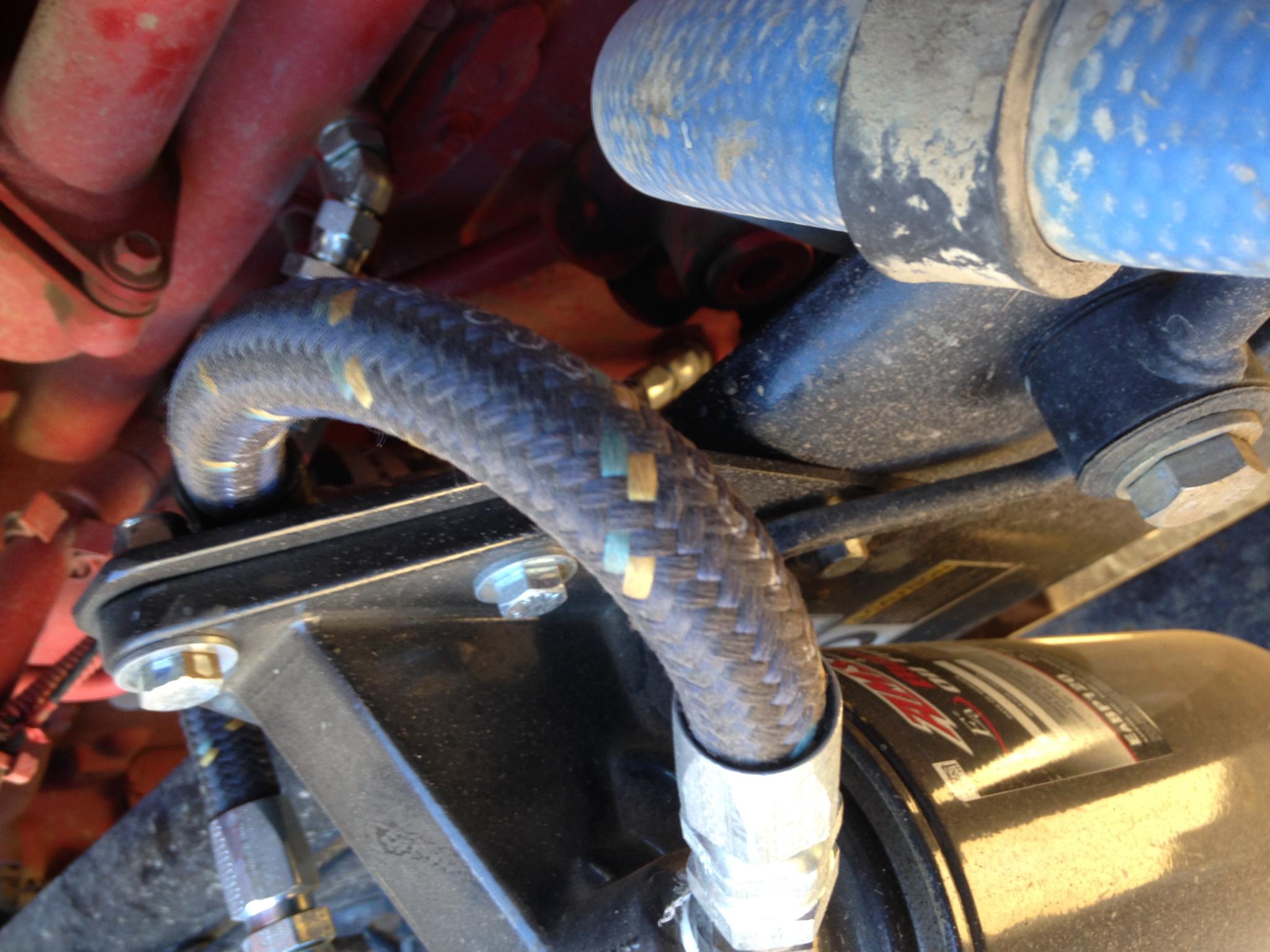

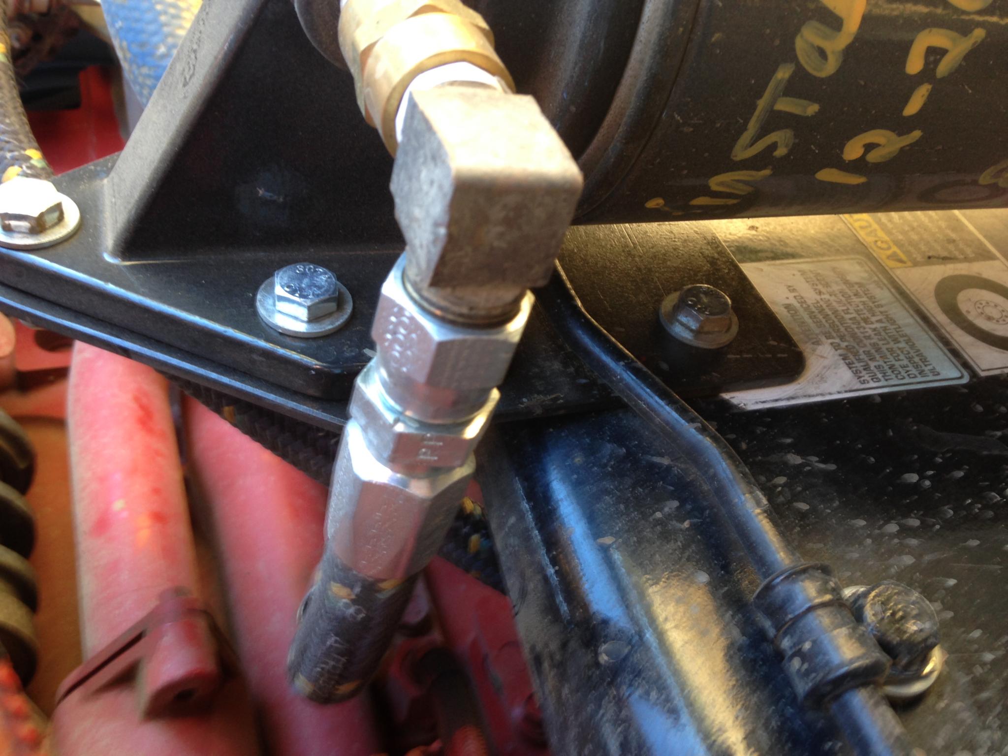

Here’s how I did my mount.
That's waaay to close to the front tire for me. Hit a piece of tire, in the middle of the night. A rock, bolt or something else laying in the road. That things gonna get hit, just asking for trouble. God forbid you blow a steer tire. I liked how Rawze did his. But mine is on the drivers side, my generator was in the way. But it's safe and also away from the heat. I feel it helps keep the oil cooler.
 Thanks given by: Toolguy
01-03-2020, (Subject: ISX and Bypass Oil Filter Systems )
Post: #104
RE: ISX and Bypass Oil Filter Systems
I don't like that one at all. I would rather have it up by the steer tire than down under the frame like that. That's a good location if it were on the side of the frame rail and not under it. That would just plain scare me. Keep an eye on your oil pressure gauge!!
it's been there a long time and I have great oil pressure, she has 1033078 miles. It looks lower in the picture than it really is.

Also I was asked for some better pics of install I see some use J bolts but I have a mag drill so it's easy to put a few holes in the frame you can buy carbide tipped hole saws they work good with a battery operated drill the one's I use are made buy champion
