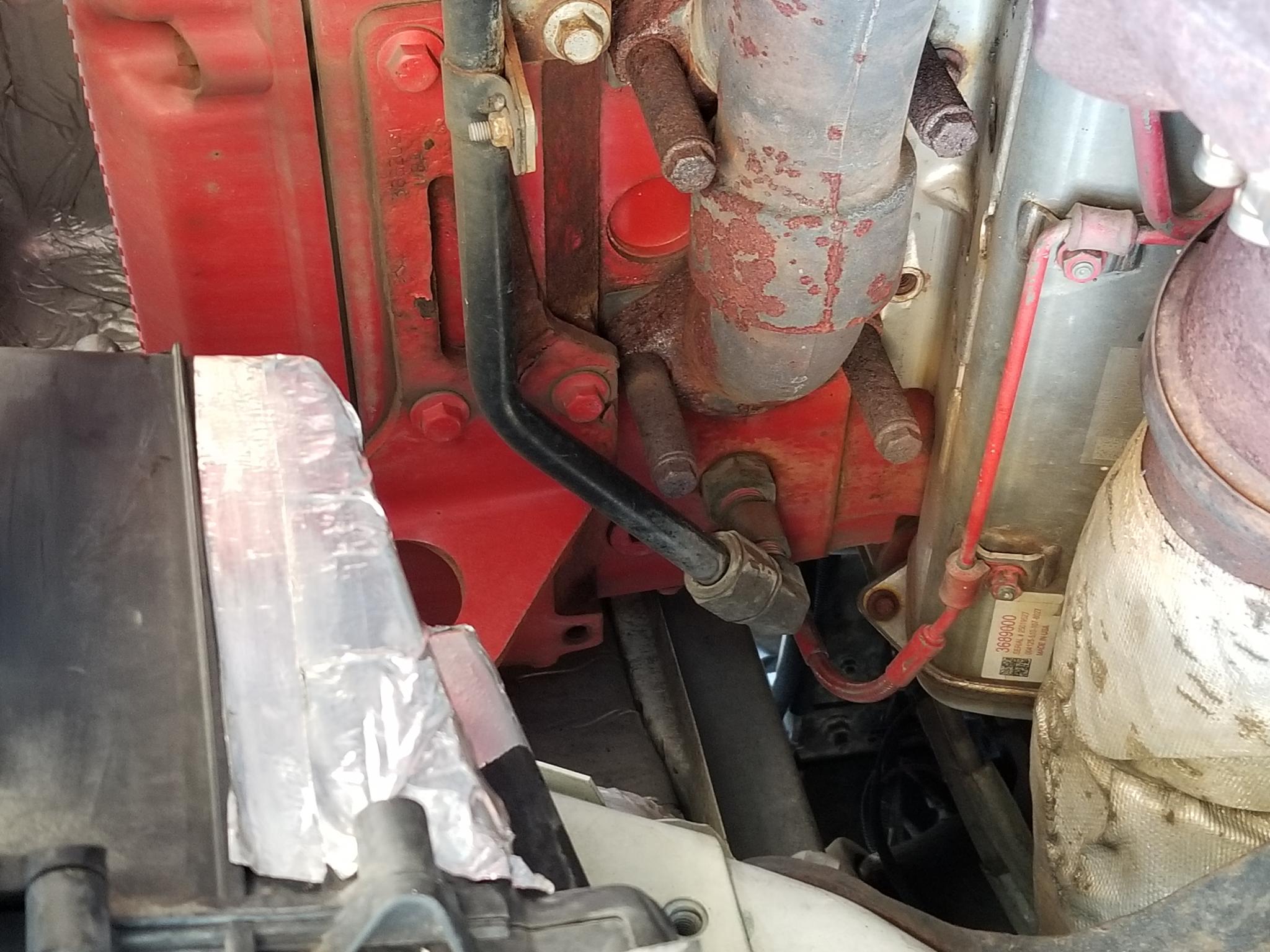

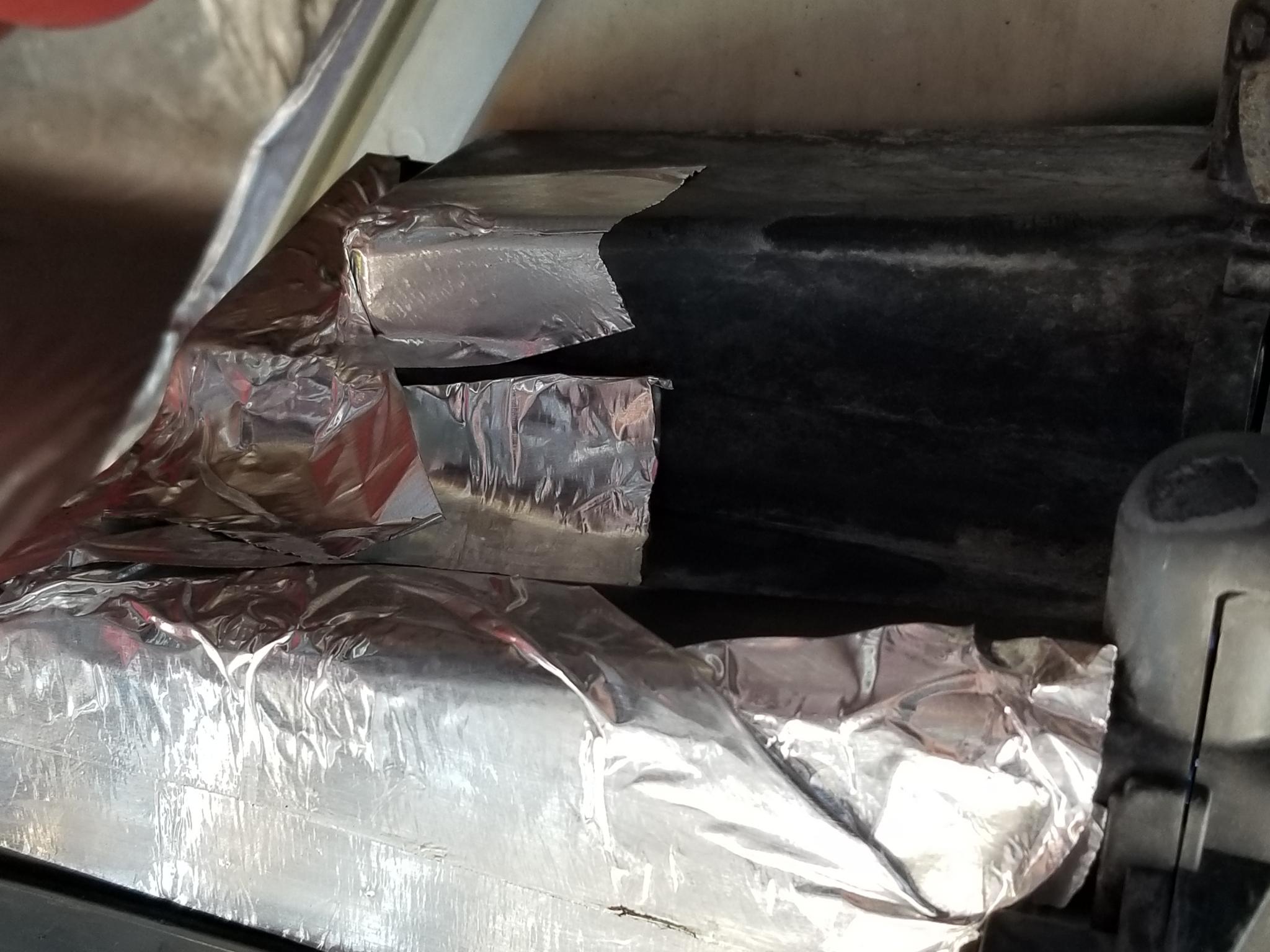

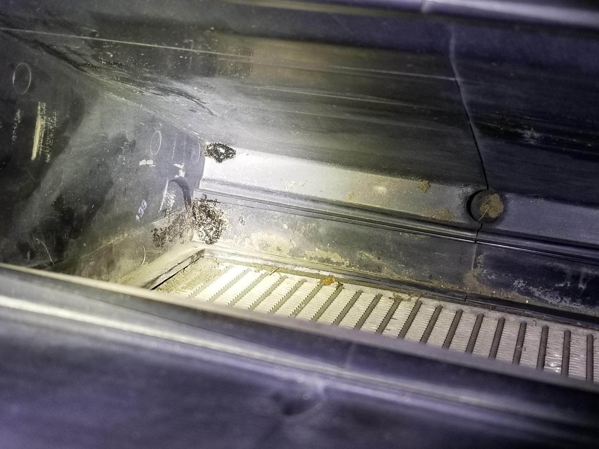

Check the bottom of your hvac unit under the hood, right above the turbo. I bought this truck used....think it may have had a exhaust leak at one point or the the severe heat given off by the turbo caused the plastic to deteriorate and crack. I had two 1/2 holes in the bottom of the case...sucking in hot air causing the evap. to freeze up. A little black rtv and some hvac tape and we are good as new. The
