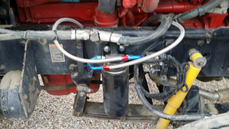

05-15-2016, (Subject: ISX and Bypass Oil Filter Systems ) Post: #36 | |||
RE: ISX and Bypass Oil Filter Systems Well here's where i try to post a picture of my install of my bypass filter.. ![]() sorry it's a little blurry. | |||
