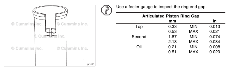

Ring gaaaaaap.
Top ring, .015"
2nd, .069"
Oil, .010"

(12-26-2019 )Nostalgic Wrote: [ -> ]Top ring, .015"
2nd, .069"
Oil, .010"
here is the official spec...
[attachment=5990]
